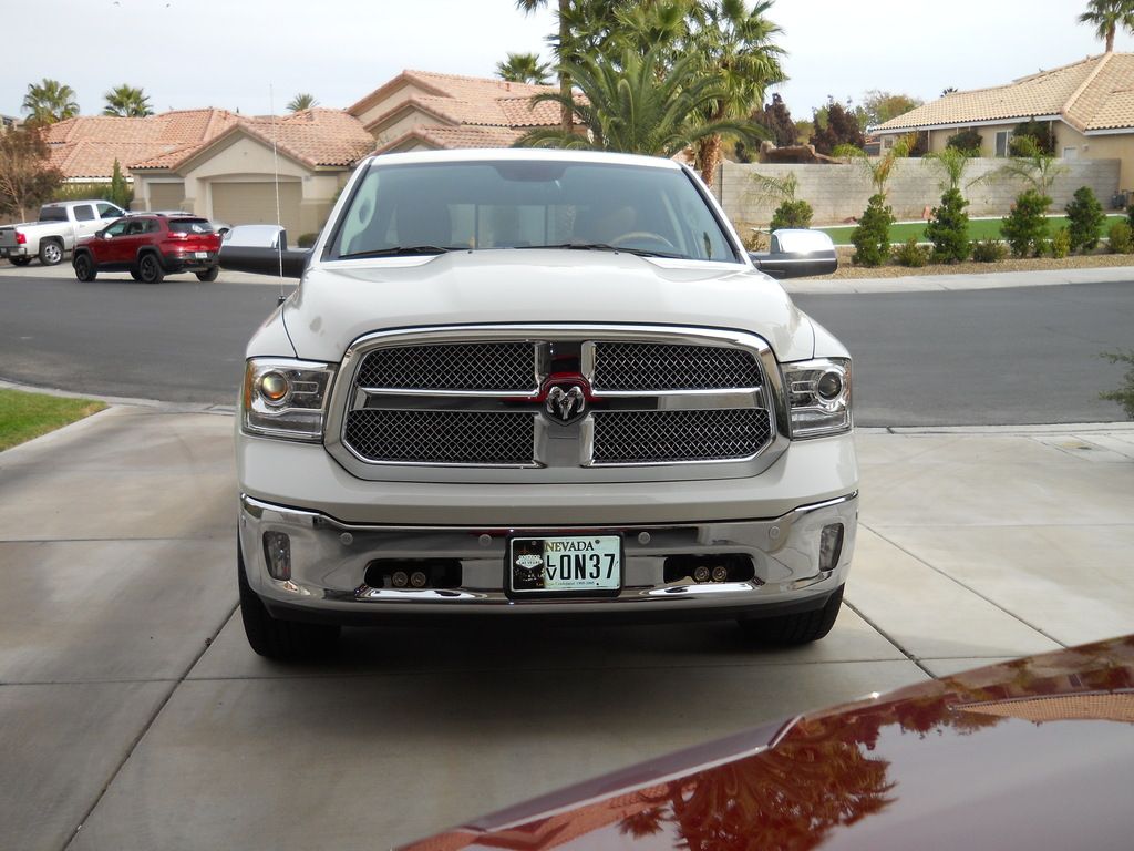

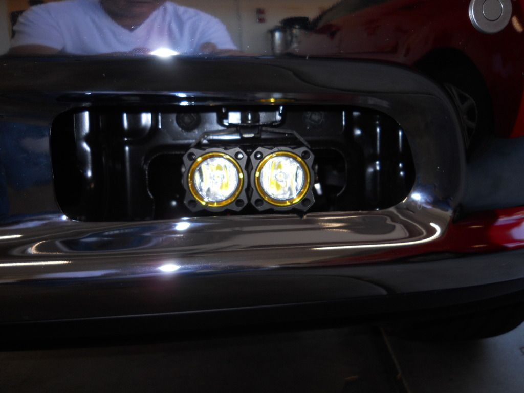

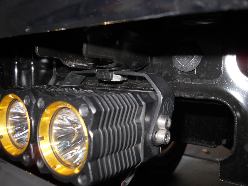

I found the fix for the absolutely poor driving lights on these trucks. I just could not believe that was the best lighting they could give us. I saw these KC Hilites in the 4 wheel parts store and thought they might work. I removed the tow hooks and installed the lights in those slots. You just need to drill one hole in each slot and hook up the wiring which goes straight to the battery and install the lighted switch under the dash. Now I must add that these lights are pretty expensive ($400) but they work great. You have to come to the realization of do you want/need tow hooks or would you like to see where hell you're going.
[URL=http://s1174.photobucket.com/user/fdny37/media/DSCN0589_zpsdfskvhla.jpg.html][/URL]
[URL=http://s1174.photobucket.com/user/fdny37/media/DSCN0586_zpshvsbga2x.jpg.html][/URL]
[URL=http://s1174.photobucket.com/user/fdny37/media/DSCN0585_zpspddu6oxw.jpg.html][/URL]
[URL=http://s1174.photobucket.com/user/fdny37/media/DSCN0593_zpsmfzhwr6a.jpg.html][/URL]
KC HiLiTES | Flex Single LED Lights for Spread Beam for Motorcycle, UTV, ATV and Offroad Vehicles
