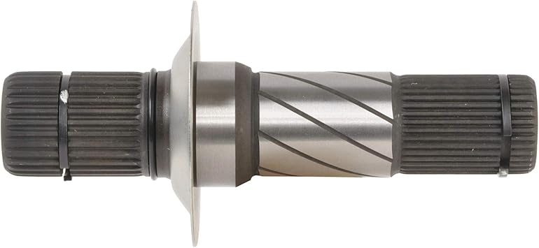

Has anyone tried replacing CV axles and as you hammer it out, it seems like the dust cap is coming with it? Is that normal, or am I somehow removing the entire shaft from the front diff? My fear is if I keep going, I end up pulling shaft out and put pours all my fluid and would need new seal from somewhere.
Anyone have tips for removal? Seems to want to move but in the wrong spot???

I did both.
Driver's side is the one where the intermediate shaft came out with the CV Axle. No fluid came out, likely because the fluid level is below the axle level.
I ended up buying a new intermediate shaft for about 50 bucks and replaced with the CV axle. Went very smooth.
