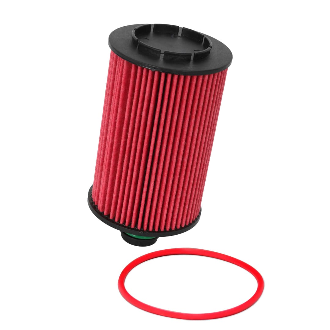

I use K&N oil filters in my ecodiesel, both the PS-7042 Professional Series $8.99 each and the HP-7042 Performance Gold $12.99 each have 56 pleats so they have far more filter media area than the Wix oil filters you have. Filter media area is another area that is important.
I have both the PS-7042 and the HP-7042 and the HP-7042 uses a better quality rubber o-ring and the filter media even feels just a little better. Both are good oil filters.
The PS-7042 uses a Nitrile rubber o-ring while the HP-7042 uses a Viton rubber o-ring.

Being that FCA decided to go with a cartridge style oil filter we have fewer choices, for me I will use the K&N HP-7042 oil filters and would not hesitate to use the K&N PS-7042 oil filter as well. If you are really looking for surface area then you want a filter with more pleats, the more pleats the more surface area it will have.
