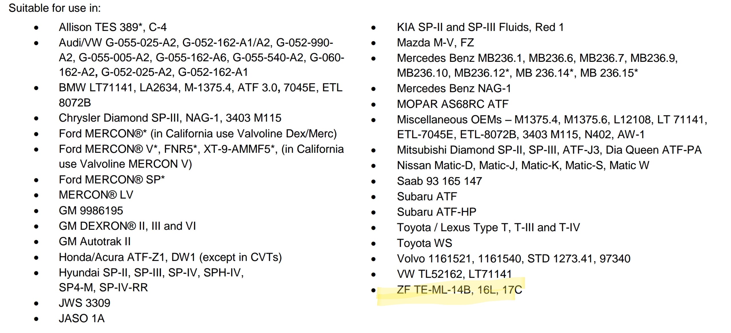

Hey guys ordering the filter / pan from Rock Auto (replaceable) and using approved amsoil fluid (13$ cad per L) . This service is going to be affordable. Finally. Lol how many liters are you guys putting in ?
#23 ·
Is that the PPE aluminum pan? It will take at least 8 liters. I'd get 10 to be sure. You won't be fully swapping fluid, about 4 liters will stay in there unless you do the service a few times in a week, but that seems wasteful.
Sent from my SM-G900V using Tapatalk
#22 ·
i know guys have been using that fluid with no issues. im going with AMSOIL because it actually states 8&9 speed transmissions. I also need some CVT fluid for my wifes compass.
